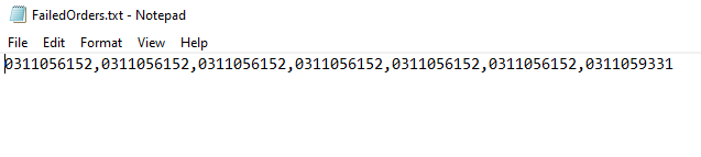

Yes error gone…if you can tell how can I print this?
String.Join(“,”,listSONumbers)
IS there a logic after that to only take unique values of sales order numbers and not repeatitive one?
Thank you sooo much :slight_smile:
(From d In yourDataTableVar.AsEnumerable
Where d(“Status”).toString.ToUpper().Contains(“FAIL”)
Select s =d( YourSalesOrderColNameOrIndex).toString).Distinct().toList
Thank you so muchhhh :slight_smile:
