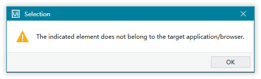

The indicated element doesn't below to the Target Application
Dear all,
How to solve the problem below:
@jackie.yue
That means you indicated a differnet window un use application or browser…
Please indicate on the same window
Even a pop up is considered as different window for few
You have attached the different window in use browser application.

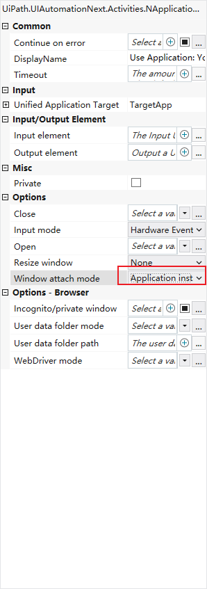

Also check what is selected under options in use application/browser…you need to select application instance…that would allow to work for pop up on same screen

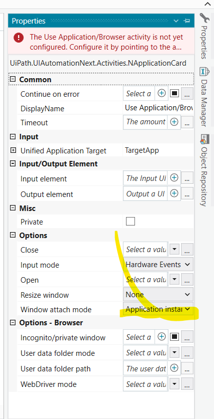

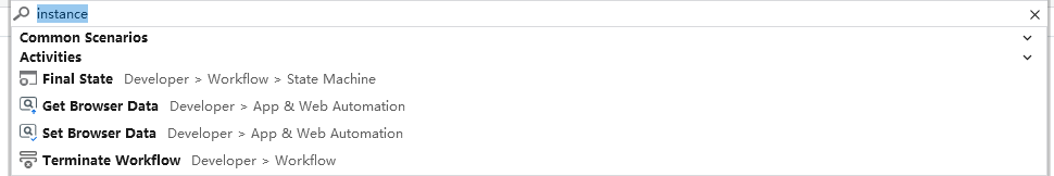

Is application instance a process oder? I can not find it.
@jackie.yue

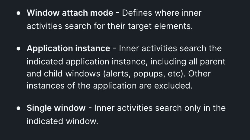

This is a option present in use application/browser only…open properties and check foe windows attach mode and select application instance and try
If changing this also gives same error then use another use application/browser activity and indicate the pop up
The mode is application instance and I also changed it to “single window”. But it doesn’t work.
