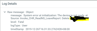

The device is not ready - issue while running the process through orchestrator in VDI
Has anybody faced this issue, this sometimes happens in the middle of the process while BOT is deleting and excel sheet. from local drive.
This issue I have seen only while running in VDI, runs perfectly in local.
It generates a system exception and BOT fails.
If possible can I have the screenshot of the error you were getting
Cheers @Faraz_Subhani
This is from the logs
On the screen, the process simply stops without popping up any message.

Hi, so I don’t have permission to restart the service, anyways I have restarted the VDI(not sure if that restarts the service as well), but even after restarting VDI i am facing the same issue.
Hi, thanks for your response, actually I never go and delete any sheets using my ID.
I will tell you the scenario.
So the process involves extracting details of few employees, can be any number, for every employee 1 excel sheet is downloaded, details are extracted, few other processes are involved and then the sheet is deleted and another sheet is downloaded for the next employee.
BOT deletes sheets for employees except for the last employee and throws system exception saying that-‘Device is not ready’
