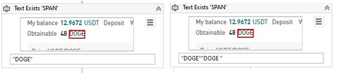

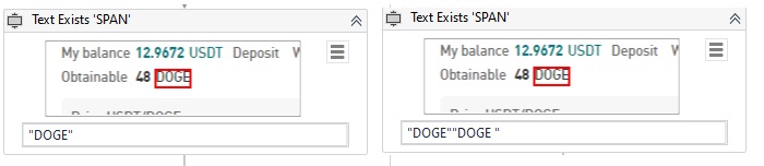

Hey,
I’m using Text Exist activity but message box showes false. I tried two ways as in screeshot. I don’t know if right one is even correct. Any idea how to get true value?

Here is my selector. DOGE is only for training purposes : D
Looks good for me. Still don’t know what’s wrong: /

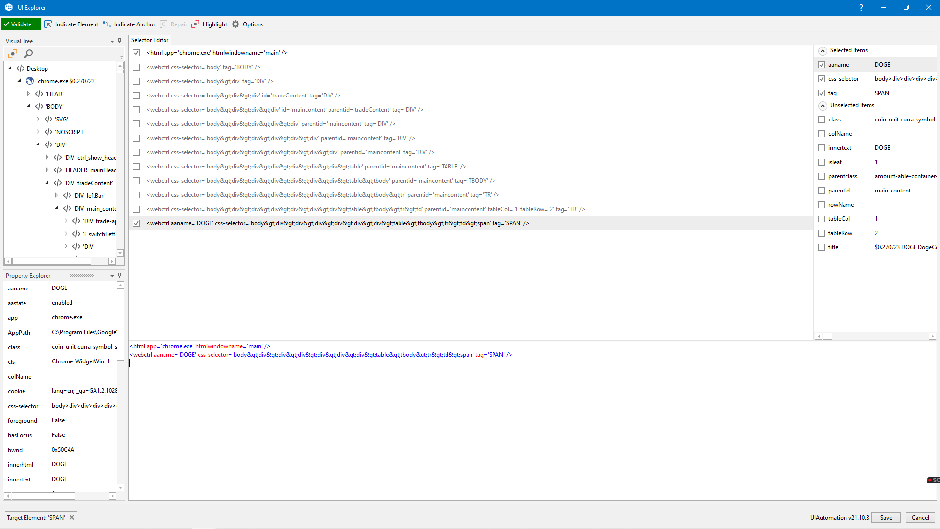

Open it in UiExplorer you can find this option on text exists activity. click on the 3 lines and you may see the option like open in UiExplorer
then take a snap and send it to me
NaNi
Here you are :grinning:
Uncheck css and tag. And also delete the variable and again create the new variable inside the text Exists!
