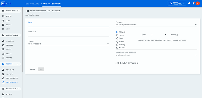

Test Schedules section
Additionally, to starting a Test Set manually, it is also possible to schedule the execution of a Test Set. This allows you to e.g. setup reoccurring execution of your Test Set once per Sprint.
