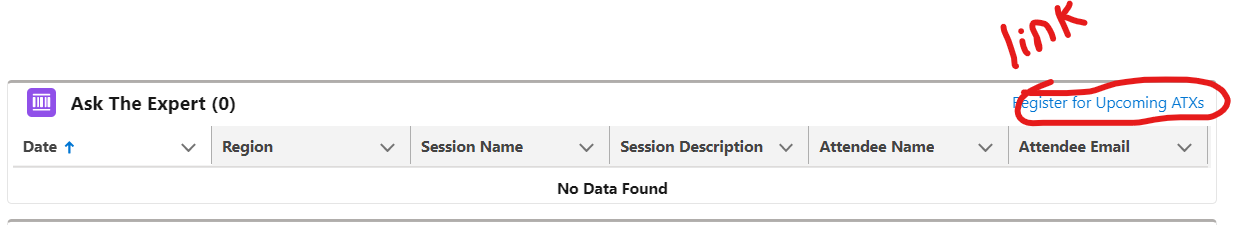

Hi Community,
I’m working on Salesforce application to automate the test cases using UiPath tool.
I am using Test Automation framework to perform test cases automation.
Use Case : 1. Verify whether a text is a hyperlink or not.
2. Verify if a table contains all the mandatory columns or not.
3. Verify Edit button is disabled or not
Please help me how can I verify.
I tried data scraping but in salesforce application is not extracting table data.
Any help would be appreciated

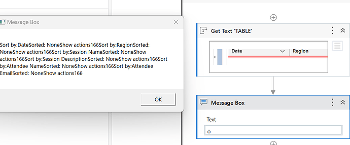

@Vaishnav_Tej
Try using get text on the first row containing all the column names and then check if the returned value contains the column names or not
For selector please open ui explorer and try finding
It is not indicating first row. It is indicating either entire part of “Ask The Expert” or as show below

Hi
It is extracting all column names as shown below
How to give the condition so that it verifies all column names present or not ?
For Hyperlink, I’m not finding href attribute & tag A for some of the links.
Is there any other alternate way?

What are you getting for hyperlink? What kind of tag or value…does it have a script linked to it?
