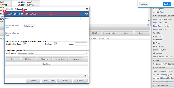

I succesfully select a target and anchor it but then whenever I run it or try to edit it, the target moves slightly up and turns red.
What might be the solution?

target selected succesfully in the 1st photo then everytime moves slightly up as seen in the 2nd photo. Tried all kinds of selectors. Keeps doing same upward move.

I would use UI Explorer and view more options or change from fuzzy selector to strict selector. In your first SS the aaname is blank.

Please use ui explorer and check the center menu…where you might file a selector containing the field NAME.Then you need not use anchor
