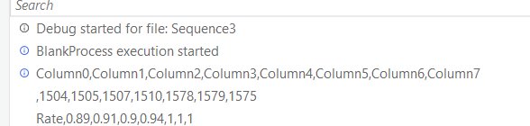

Hi @Anil_G
We have to update the value in Rate sheet Rate column as per plant numbers .
Means if the value for 1504 is 0.89 it has to be placed in the rate sheet under 1504 same if 1575 has value 0.98 it has to be placed under 1575 only.
@Kunal_Jain
The same is happening…writing to excel is somethign that I did not add…please add those steps…logic remains same
cheers
