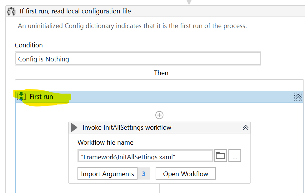

I am currently using the re-framework. The queue is set up to have a max retry of 2 when a system exception occurs. However, the item keeps getting re-added to the queue despite failing with system exceptions more than twice. How do i fix this?
Did u set retry no in config too?
@happygal321
Check the add queue activity is inside the If condition of First Run Block as below
Hope this helps you
Thanks
its 0 in config, and 2 in queue
Thanks!
