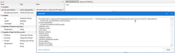

Can you check content of $exceptionDetails at locals panel when run as debug?
Probably there is detailed information for the exception.
Turn on Break on All Exceptions (Debug, Exceptions) and rerun the program.
This will show you the original exception when it was thrown in the first place.

Hello @Varun_Dharni
Can you try changing the File location and test it once.
Maybe you can move the file to the project folder and try to read it.
