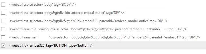

Stefano,
Thanks for the reply. Below is a pic of the full button when I do an Inspect. The highlighted line is what I am seeing in the Selector field within Studio.
I am sure the answer may be here I’m just not seeing it.
Here is what I see in UI Explorer:
And this:
button3
Hi @djkmod83,
Have you tried using the id attribute as id='ember*' and adding the aaname and type attributes? I imagine this would work if there is only one Submit button available
Finally got around to trying this and i opened the element in UI Explorer, selected the id, aaname and type attributes then changed the id to ember* and still does not work unfortunately. But yes, this is a pop up window that only has 1 Submit button
Hi!
uncheck the id and just keep only aaname.
this will works for you
