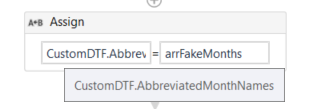

Parsing with a custom Set of Abbreviated Month names:
Variables:
Assigning the FakeMonths to the CustomDTF:
so we can also parse:
DateTime.ParseExact("17Kkk2020","ddMMMyyyy", CustomDTF)
