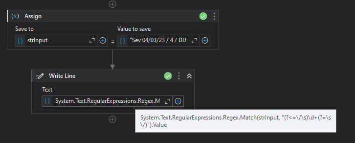

Hi @Umer_Shahid
What about the following?
System.Text.RegularExpressions.Regex.Match(strInput, "(?<=\/\s)\d+(?=\s\/)").Value
Regards!

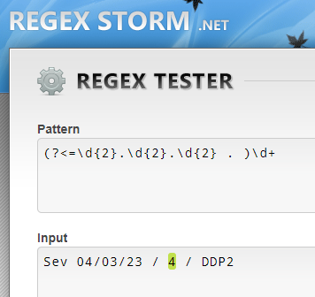

Hey @Umer_Shahid
Here is another regex pattern which is ‘anchored’ on the date.
System.Text.RegularExpressions.Regex.Match(strInput, “(?<=\d{2}.\d{2}.\d{2} . )\d+”).Value
Hopefully this helps,
Steve
