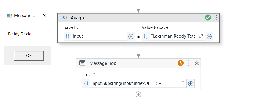

Hi @Dillon_Marius
Can you try with this
inputString = "Lakshman Reddy Tetala"
outputString = inputString.Substring(inputString.IndexOf(" ") + 1)

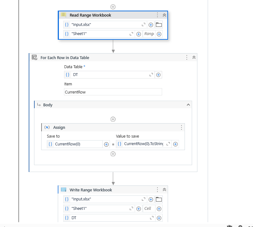

Could you show this formula in for each row form? (forgot to mention in the post)
Also does it work on both scenarios where there are two words value and three words value?
Thanks
@Dillon_Marius
CurrentRow(0).ToString.Substring(CurrentRow(0).ToString.IndexOf(" ")+1)
Input
Output
