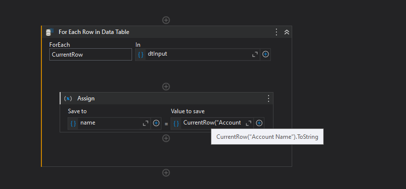

Hi @dutta.marina
Asuming that you are already looping through your datatable, then just use an assign activity in order to store the desired value like this example
CurrentRow("Account Name").ToString

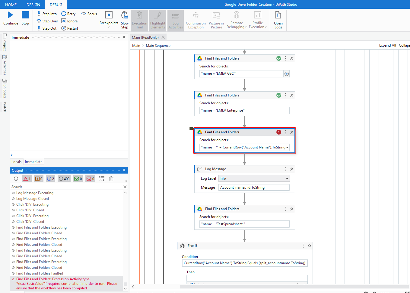

Hi Srini,
Actually I am using Gsuite Application and Find files and folder activity in Google drive. Instead of TestSpreadsheet my folder is dynamic in nature based on current row values which will be created in google drive . Hence instead of TestSpreadsheet I should replace it with
CurrentRow(“Account Name”).ToString to find the current dynamic folder which will be created at run time.

Hi Nitya ,
I am getting this error. Find Files and Folders: Expression Activity type ‘VisualBasicValue`1’ requires compilation in order to run. Please ensure that the workflow has been compiled.
I compiled also but no error during compilation.

@dutta.marina
Please try this… the inverted comma you are using in code is wrong just remove from code and re add or use the below
"name = '" + CurrentRow("Account Name").ToString + "'"

@dutta.marina
Can you correct the double quotes in name and other, because it is showing some inverted kind
