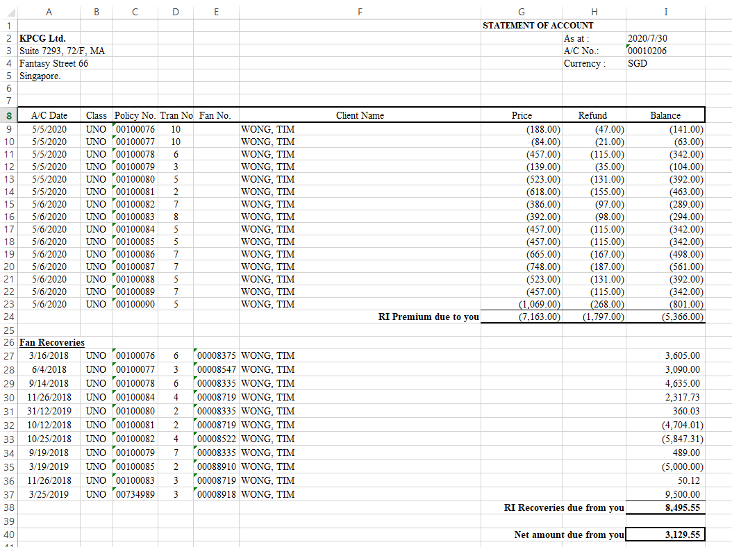

Hi there. I was assigned a task which requires some numbers to process some information. Refer to the picture below, There are two sets of policy numbers (1st set from C9 to C23; 2nd set from C27 to C37). My questions are:
  1. How could I set the code so that the robot knows to read the first row cell C9 and end with the last row cell C23 and store in the datatable1? The first row must be the row cell immediately below “Policy No.” (which might not necessarily be located in C8). The immediate row cell below the last row should always be blank (i.e. C24 in this case).
  2. How could I set the code so that the robot knows to read the first row cell C27 and end with the last row cell C37 and store in the datatable2? Perhaps we could set the first row to be the row below “Fan Recoveries” (i.e. A26) and read the string in that row under Column C? Or are there better methods?
  3. After storing the 2 sets of policy numbers in the two data tables. I need to use those value to perform search for new information. For that, I will create another two corresponding data tables to save the information inside them. Suppose I have save all values to those data table. I would like to input the value to Column J.
  • For example, I will use the value in C9 to search new information. Let’s say the search result is “Good Performance”, the robot should input “Good Performance” under J9. Same for C29, the string of the search result should be pasted into J29. The problem is, how could I paste the first row of the data table into J9 and J27?

Attached is the Excel file. The search will be performed in our company’s internal system. With the policy numbers available in DT1 & D2, I am able to do it myself and save to DT3 & DT4. However, I don’t know how the robot will know to paste the first row in DT3 to J9 and the first row in DT4 to J27 in this case.

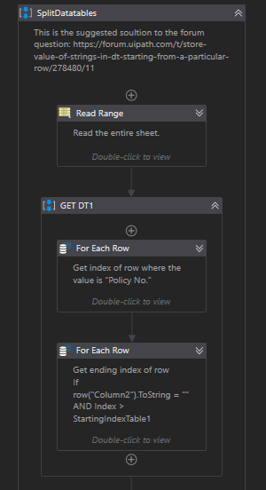

Hi @wth1993,
That was an interesting question!
As you say the row index can be dynamic. This proposed solution will work if your column structure is as shown in the Sample file.xlsx and can handle dynamic row index.
Approach for DT1
  1. Look for a particular value in Column2(Column 3 in excel) if it is “Policy No.” then save the index as starting index for table 1: Save to StaringIndexTable1
  2. Look for an empty value in Column2 and ensure the value is after the starting index (in short look for the end of the table) save the index as ending index for table 1: Save to StartingIndexTable1

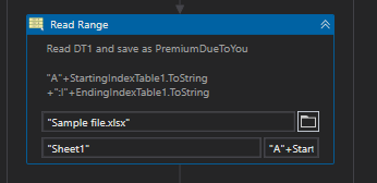

  3. Read the excel file for the given starting and ending indexes (Hardcoded “I” column)
Output (PremiumDueToYou):

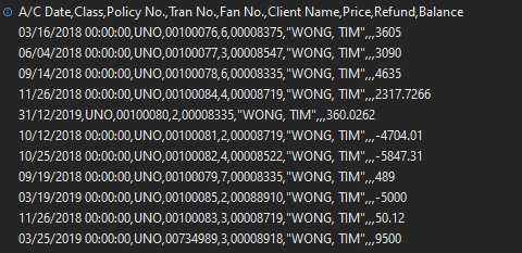

Approach for DT2
A little tricky because here when we read any range our columns will not have headers.
  1. Same as for DT1 but looking for “Claim Recoveries” : Save to StartingIndexTable2
  2. Same as for DT1 but looking for empty value and index > StartingIndexTable2 : Save to EndingIndexTable2
  3. Lets clone DT1 to get the column names : Save as RIRecoveriesduefromyou (Datatable)
  4. Read the excel file for the calculated ranges from Step 1 and 2
  5. Use a for each Row loop and add the row.ItemArray to RIRecoveriesduefromyou (Datatable)
Output (RIRecoveriesduefromyou):
To your other question: How will the robot know it should enter J9 and J27
Essentially you want to use the StartingIndexTable1+1 and StartingIndexTable2+1.
In this example case these are 9 and 27 respectively. The +1 is to ensure that the robot leaves the header “Result” intact.
Here is the XAML file for your reference (input file is your Sample file.xlsx): SplitDatatables.xaml (25.9 KB)
Hope this helped a bit!

Thank you for your perfect answer.
Since I only need the policy numbers in Column C instead of the whole table, I changed the Range to “C” + StartingIndexTable.ToString+“:C”+EndingIndexTable1.ToString.
