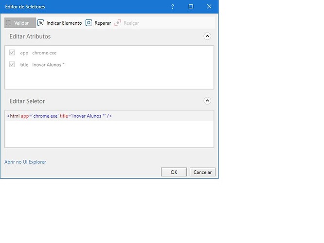

it work only if in hotkey i do not use that field attribute ( id or whathever other) as in last picture
as you see i send the hotkey for that aplication but not for any element. As i have “selected” before the element that i want so as far as i can say and for while all is working.
i’ll send you also the selectors of that field:
