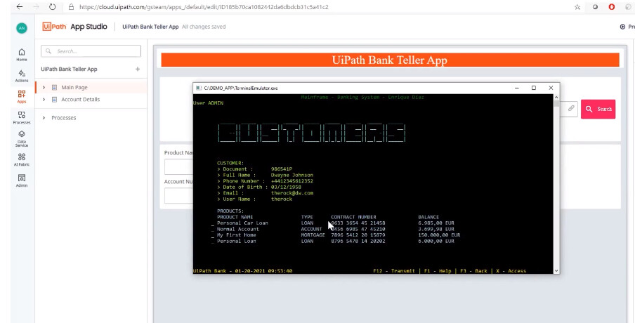

I’m developping an UIP-APP like the akademy demo with the ui path bank (Terminal-Demo). But as I want to do this on an unattended machine every single process will logon-on to do the activites and logoff again. This takes much to long.
I would like to assign an unattended machine, where I can start a session and navigate in the app if an user wants to get another account for example.

User starts UIPAth APP (unattended machine will log-on and open Demo_App\TerminalEmulator.exe)
User requests account or Tom Crusie, and gets ProductName
User requests account for Ned Kelly and changes Balance
User requests details for other customers (i.e. when they call in)
At the end of the day, users shut down the app and the unattended bot will log-off

Have you seen this video:
This shows my use case with one difference: this will work as attended. But I want to get this run unattended. I can start the process on an unattended machine, but this will log-on for each process.

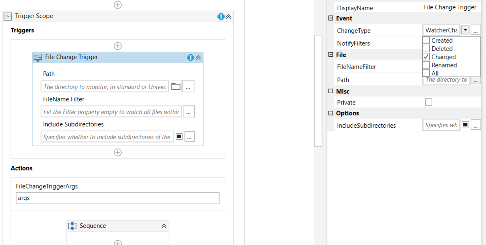

Your idea with an status excel file sounds good. But which activity will listen to an excel trigger?
@TP2B
I belive you can try with the File Trigger
Hope this may help you
