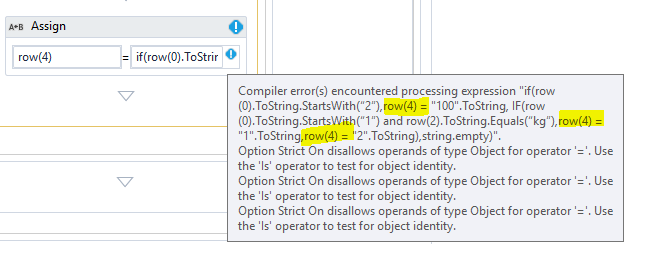

@Palaniyappan its throwing a error please look into the screenshot
remove these row(4) = and keep just the values like β€œ100” β€œ1” β€œ2”
as we are using aassign activity here
Cheers @Shriharsha_H_N
@Palaniyappan
the expression will be like this
if(row(0).ToString.StartsWith(β€œ2”),β€œ100”, IF(row(0).ToString.StartsWith(β€œ1”) AND row(0).ToString.ToUpper.Equals(β€œKG”),β€œ1”,β€œ2”),string.empty)
No same error
aah got it
remove the string.empty
if(row(0).ToString.StartsWith(β€œ2”),β€œ100”, IF(row(0).ToString.StartsWith(β€œ1”) AND row(0).ToString.ToUpper.Equals(β€œKG”),β€œ1”,β€œ2”))
