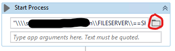

I’m currently trying to run an .exe file who is in an intermal fileserver that I have access to.
While using the Start Process Activity, I can find the file using the browsing button, but getting this issue once I run the Sequence :
Any ideas ? Thanks !

Hello,
Here is how I do it :
uipathissue55
Thanks
I also tried by copying directly the file path manually and I get this error :
HI @gamakichi
In the Path
Change \ to single slash and try again once
like
\\Netwrok\FILESERVER\==....
Regards
Sudharsan
@gamakichi
I see there are extra slashes can you please try removing them and try
\dhhdj\dhdjdj….
Like this
Hello,

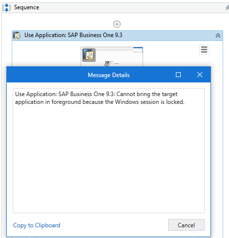

I’ve done more tests and I don’t think the issue is related to the FilePath, for any application that I try to run from UiPath Studio I got this error :
I’m currently using the session so it is not locked and I haven’t found any solution on the forum.
Any ideas ? Thanks
@gamakichi
Can you try upgrading the uiactivities and the system packages and try again
Ideally this error comes only when the windows sessions is minimized or locked …if it is active and you are seeing this errors might mean the packages are out of date.so please try the same
And coming to system cannot find path…can you try using the same path in run or file explorer and check if the path is working
Alternately it is better to check the locals panel exception details which might give more information like if it is using full path or truncating it…accordingly we can get to the root cause
