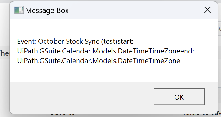

Thank you for your reply.
I did try the above provided solution before but I am getting the below output. It shows the summary but not the start and end time
@Sheela_Ippili
One more step to it…which would give the datetime
use currenItem.Start.DateTime and currentItem.End.DateTime
It worked! Thank you so much!
