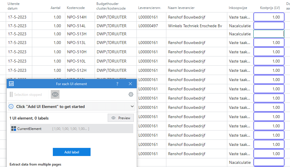

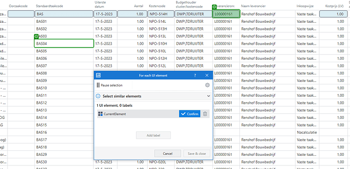

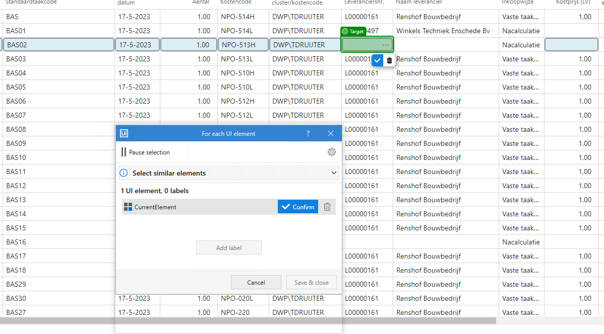

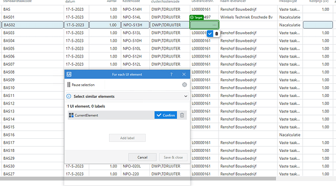

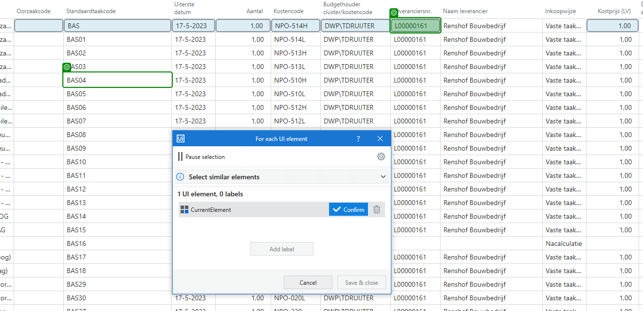

I am trying to use the for each UI elements now! If i select the first row column in dynamics it will only select one row:
but if i select the row and target one lower or higher it will grab the whole column correctly:
@uiStijn
So the For each ui element works right…except for the first row
Try including any other rows from the selector editor in the ui explorer…may be the path to the row is not being identified I guess
Or the selector is changing during runtime …check using ui explorer while running as well to know the different without stopping the bot…
cheers
