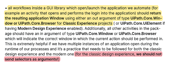

I’m going through one of the PDF documentations packaged in a Solution Accelerator.
I see instructions to switching between Classic and Modern experiences in the PDF. But these UI features have evolved in the latest studio (2024.2.*) CE updates. This is a screen shot from the PDF that I have read through and recorded comments on.
This is at the Project Level:
And this is at the Studio Level:
Both of these do not exist in the latest 2024.2.* update of Studio. Therefore I went back to the documentation online and found this note:
Therefore, I presume that the online documentation is the right way to go. And sure enough I can see the classic activities after following the online documentation.

The documentation on reusability advises that we should return a reference to an application or Browser window.
I wanted to do something like this for an Excel Workbook object (output by the Classic Excel Application Scope activity).
I don’t know how this is done in the Modern Excel counterpart and therefore wanted to switch to the classic mode and ended up taking a detour.
