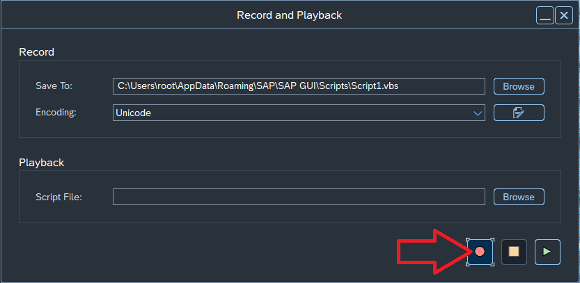

Is it possible for you to record and replay SAP GUI Scripting?
Choose SAP GUI settings and actions.
Choose the menu item Script Recording and Playback…
Now an additional dialog pops up. Press the record button and call a transaction code.
Press the stop button, go back to your SAP start screen and press the replay button.
If this works you can be sure that the SAP GUI scripting is installed and configured correctly.
You can find more information here.
Let us know your results.

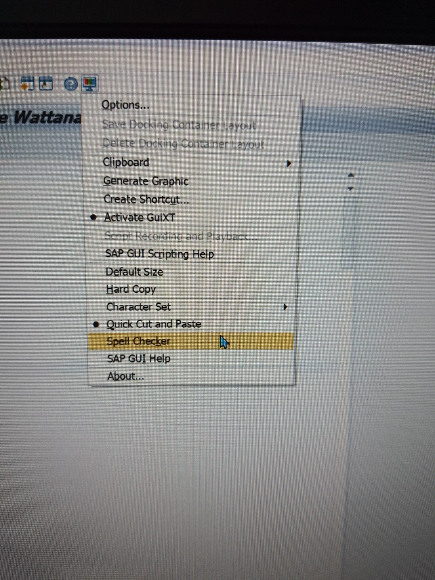

Hi Stefan
The script recording and play back is dimmed and unable to use as attached.
Not sure locked by policy or not.

@Supreedee
Hello Supreedee,
check this Configuration Steps:
  1. On Client Side - You can do it by yourself, without any admin rights.
  2. On Server Side - You must do it with your SAP Admin from the Global Team. Check all parameters, user_scripting = True, all other user_scripting_* set to False. And be sure that the switch is set on all servers.
If the configuration is correct your SAP GUI Scripting should work.
Best regards
Stefan
