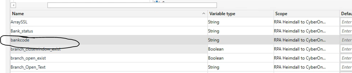

Right now I added it back and added breakpoint and will do a debug run now
this is what I have
Hmm… From the image, it should go through False side…
Can you check robot step into True side, if you press F11 2 or 3 times at the breakpoint?
