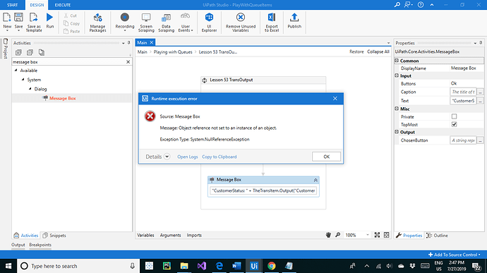

I tried to display in a Message Box the TheTransItem.Ouput(“CustomerStatus”).ToString but received an error.

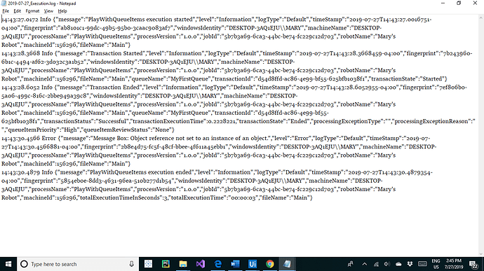

Here is a copy of the log file and I could not identify the issue.

When using the set status activity the Transaction Item stored in your local variable is not automaticly refreshed. This could be the reason why the TheTransItem.Output property is null.
Unfortunately there is no Refresh Method available :neutral_face:
Give a try on Following:
Make sure that your assigning a good ReferenceID while Adding the TI with Add Transaction Item
Use the activity: Get Transaction Item and configure the Filter to your Tansaction Item Reference ID
grafik
Overwrite the TheTransItem Variable with the retrieved Transaction Item (Keep in mind you get a list and need a single Transaction Item. Use eg First() Statement or ElementAt(0) against the the list)
With Breakpoint Debugging you can verified that now the Output Property is no longer null
OMG! It WORKED!!!
