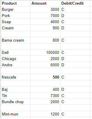

Hello experts, I have array of rows which I want to separate the grouped rows from the ungrouped rows in Debit/Credit column, here is the screenshot and from here I want to separate the single Credits from the grouped rows. image

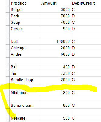

I want the single C’s to separed from the grouped as seen from the excel there must single C’s not grouped together.So all those single C’s will be separeted from the grouped, here is the required output - image

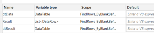

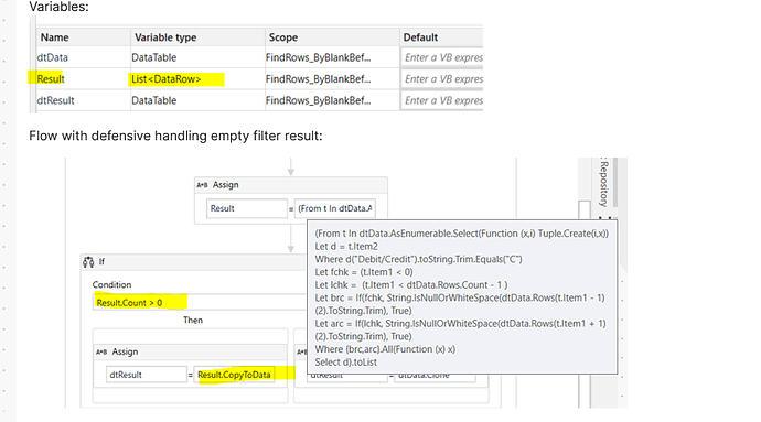

Find Quick Prototype
Variables:
grafik

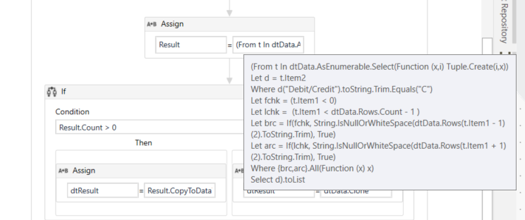

Flow with defensive handling empty filter result:
(From t In dtData.AsEnumerable.Select(Function (x,i) Tuple.Create(i,x))
Let d = t.Item2
Where d("Debit/Credit").toString.Trim.Equals("C")
Let fchk = (t.Item1 < 0)
Let lchk =  (t.Item1 < dtData.Rows.Count - 1 )
Let brc = If(fchk, String.IsNullOrWhiteSpace(dtData.Rows(t.Item1 - 1)(2).ToString.Trim), True)
Let arc = If(lchk, String.IsNullOrWhiteSpace(dtData.Rows(t.Item1 + 1)(2).ToString.Trim), True)
Where {brc,arc}.All(Function (x) x)
Select d).toList

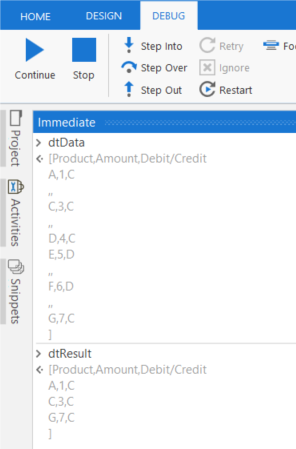

Tested with data stressing also on the borders:
grafik

Yes, that’s the result ppr. Further, I would like to remove the rows i.e the Result variable from dtData and then append it to the end of the excel sheet. How do I convert List(dataRows) to datarows so that I use it in the dtData dataTable and achieve that. Thanks

CopyToDataMethod throws an exception if the List is empty. Therefore we check the count. The implementation is described above in the screenshot
