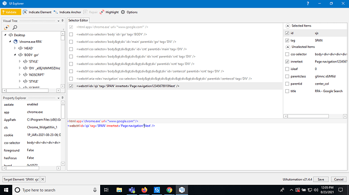

Hi @yasser_el_shrief ,
You try in Ui Explorer and can select the selector as shown below.
“webctrl id=‘xjs’ tag=‘SPAN’ innertext=‘Page navigation*Next’ /”
not working, I want the last page number right before “next” word.
There are 2 ways you can find it.
As per the above selector you will get the value like "“Page navigation12345678910Next”
From this extract only digits with regex
System.Text.RegularExpressions.Regex.Match(pageno,“[.\d]+”).Value
Now you will get 12345678910
Now check for the count of integers…if the last digit is 0 then consider last and last-1.
And other way is, if you see the pagination selector in Ui Explorer you can see all the pagination numbers are assigned to colName
“webctrl aaname=‘*’ parentid=‘xjs’ tag=‘A’ colName=‘10’ /”
If you take this you will get the last number easily.
