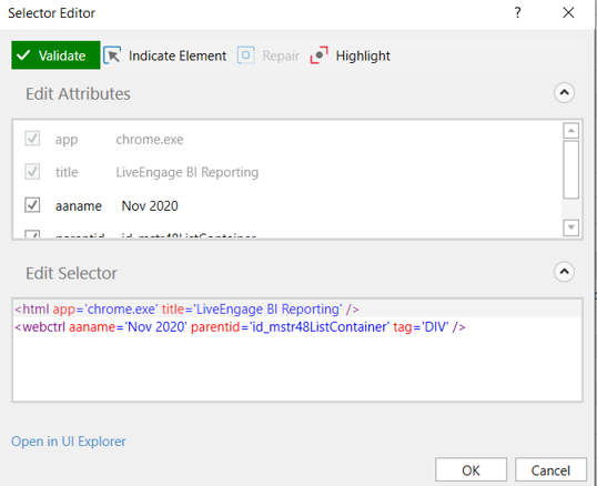

Hi, I have a problem here. i am working on a web automation (Javascript) my selector works when it is static. if i however attempt to make it dynamic, it fails to work.
The first picture works and the second picture does not work
I would really appreciate a solution.
Thank you

It didnt work. I have tried it multiple times. here is the error

here is it. thank you
Actually your variable LastMonth in selector is rightly passed
Is value mentioned correctly to that varivale
Pls check that
@Ayodeji_Osikoya
Thank you @Srini84 . i used type into and used the variable and it perfectly worked
