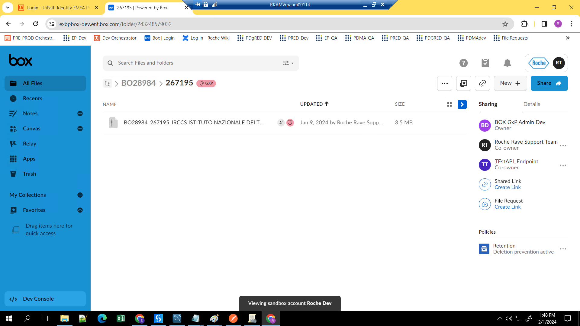

I have a relative button(New) based on which i have to select the actual button for file upload. but when running in attended mode this is working but when running in unattended mode it is not working any suggestion would be helpful .Also anyother info from my end i can provide for investigating
File upload screen
Selector for new button below

this is working in my Local machine but when I deploy this for further testing in QA environment it doesn’t work
