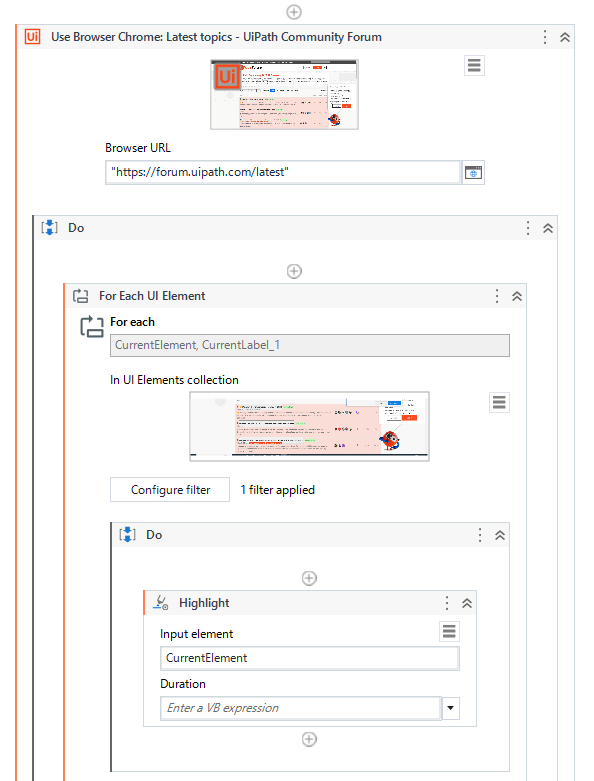

Can you try ForEachUiElement activity?
We can check if the value starts with MBLEM and click “view” in each row.

HI,
The following is a simple sample for ForEacgUiElement.
(Highlight title element which count of replies starts with “2”)
Can you check this?
Sample20230227-5L.zip (4.1 KB)
