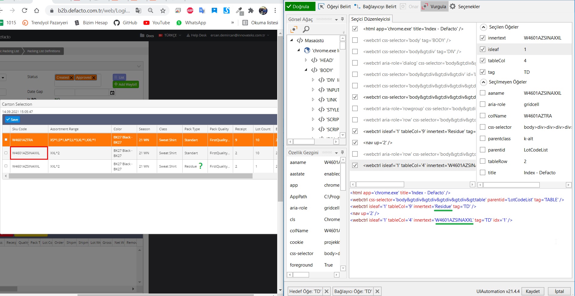

Hello,
I have a data with sku code and pack types. In a for loop, I need to select row what’s in the my data on this web page.
I can get row number with get attiribute but I don’t get with the second condition (pack type)

@bagcivan
the selector to Standart has defined the idx=‘1’. But it looks like you want to click on 2nd Standart row. Also with with innertext='460… the selector is bound to first standart row.
It is depending on how you will decide, which row is to click. In general we do have tow options in place:
  • datascraping and calculating the index. The calculated index you could e.g. use by
    <webctrl tableRow='{{YourIndexVarAsStringOrInt}}' .... />
  • find children approach

set the selector to the table
set filter to <webctrl tag='TR' />
Scope: Find_Descendants
so we wouldretrieve all table rows and can process it further if needed. In a lot of scenarios we can do it with help of LINQ.

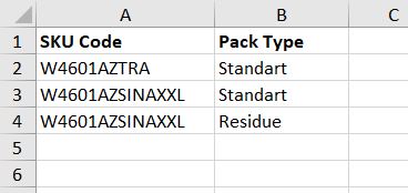

@ppr This is my data.
2021-09-14 13_38_14-packlist.xlsx - Excel
flowwork
[web page activities]
after that
  1. I’m getting the my data with read range
  2. Add for each row
  3. Assigning sku code and pack type to variable
now we have two variables;
for example
Sku Code = “W4601ASINAXXL”
Pack Type = “Standart”
according to these conditions i have to click check 2nd line in webpage,
next
Lets assume following: variables with no spaces In the name of datatype String
SkuCode = “W4601ASINAXXL”
PackType = “Standart”
Following selector
<html .......
<webctrl tag='TABLE' parentId='LotCodeList' />
<webctrl tag='TD' innertext='{{PackType}}' tableCol='9' />
<nav up='1' />
<webctrl  tag='TD' innertext='{{SkuCode}}' tableCol='4' />
ensure that the variable has valid default values, then we can test and evaluate the selector
check if the tableCol indexes are correct as we do see 4, but in screenshot it is the second Col
adopt it if it is needed
then the bot should click on the first row matching the corresponding variable values

@ppr I couldn’t find the element when I tried without using variables with this method
Confused by your screenshot as it was not trying the suggested approach? So what was done so far in detail?
There are some hidden columns. It looking when we get it with data scraping. Therefore, sku code ise 4.
ok fine, if TableCol are ok , thw use it. So now try the selector as described above. First line (parnet selector) take it as it is
Choosing row 2, instead of row 3 :thinking:
kindly note you have used nav-up=‘2’ thats why you jump up to other SKU
<nav up='2' />
I don’t know exactly what this line does.
what is the role of nav
its an integrated aanchor
it jumps to a particular PackType td
Jumps up an element to parent tr
Enters td SkuCode
But if things are unclear please do not change suggestions, thanks
When i set nav=1, it selects the residue line this is ok but when i change the pack type, it still gives an error.
we always need to know which error. Lets assume it is not vlaidating check if the default values from the variables are matching pair and reflecting the test case
