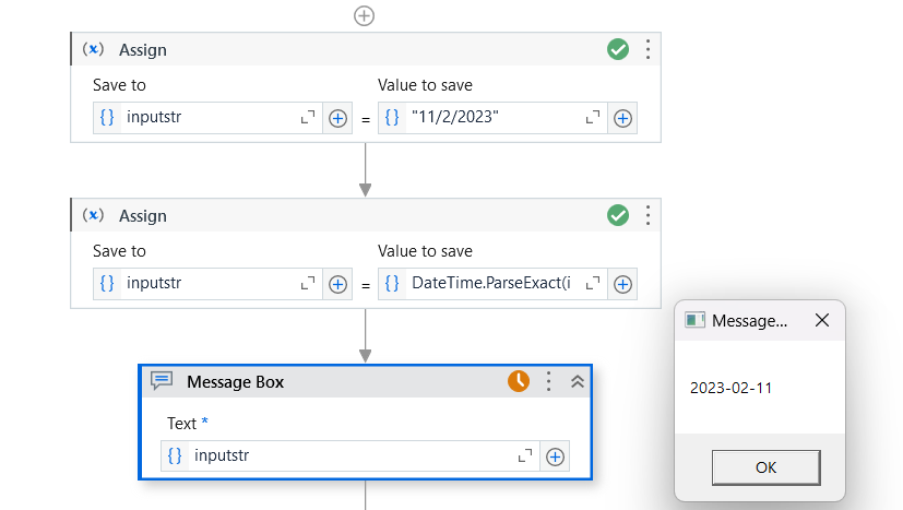

Hi @sgarg
Try this
DateTime.ParseExact(Input.ToString,"dd/M/yyyy",System.GLobalization.CultureInfo.InvariantCulture).ToString("yyyy-MM-dd")
You can pass this variable using type into activity
