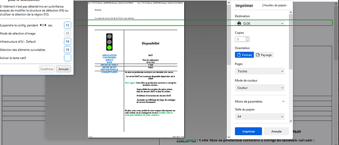

I want to save to a pdf from an html page.
However, I want to change the print settings by changing the drop-down lists.
Would you have a solution because selection is impossible…

@Julien_Horreau
When on the Print page, and the selector is active, press F4 to enable you to select elements from the print screen.
Regards
yes, he can change the item in the drop-down list but it’s as if he didn’t take my value into account because he keeps the layout of the default value …

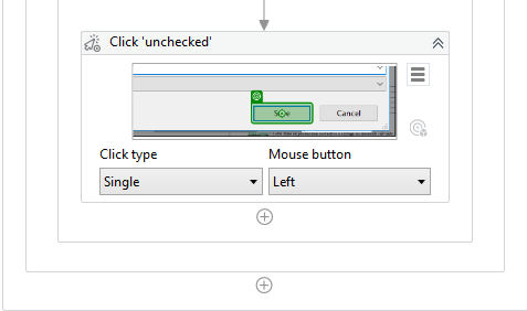

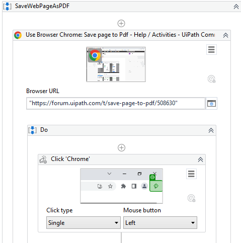

I solved my problem by:
