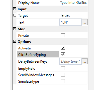

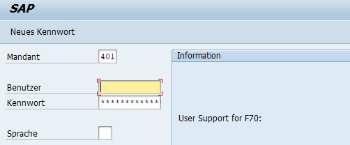

I can choose the input field with type into activity, and i want to type “EN” into the language field
However, the “EN” was typed in the user field which is the current field
I have also tried with “activate” and “click before typing” but it still doesn’t work
The only way worked for me, was to actually use “Click” to locate the current input field before “Type into” activity however, that means i need to adjust a lot of my steps in the program.
