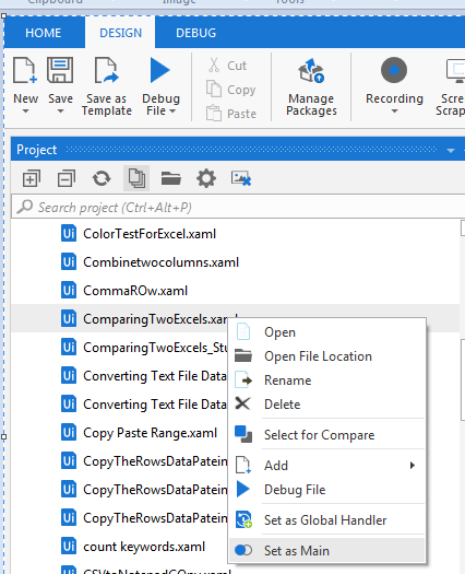

Hi @Vijay_RPA ,
Go to studio and select your xaml and right click on it ,set is as main.
Then try with the bot .

Vijay, I suspect as below:
Project 1:
Main.xaml_Set as Main
Mani1.xaml
Project2:
Main.xaml-Set as main
Main1.xaml
You removed Main.xaml from project 1 but still Main.xaml in project 2 as set as main ,so running the Main.xaml from project 2.
If my expectectation is correct ,select the xaml which you want to run from project 2 and set it as main.
