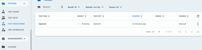

Run test cases through Orchestrator always shows pending result
Run test cases through Orchestrator always shows pending result @ThomasStocker @loginerror
Hi @Raju_Kumar1,
most likely this is the case, because you do not have a robot available to execute your Test Case.
Pls make sure that you have a robot of type Testing available, that is assigned to an environment, that has been used for your Test Set.
If you have further issues with this, pls let me know.
