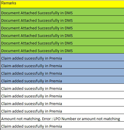

See i have an excel
if the remarks contain “Document attached successfully in dms” , it should go to the next row and and the index should be “1”
