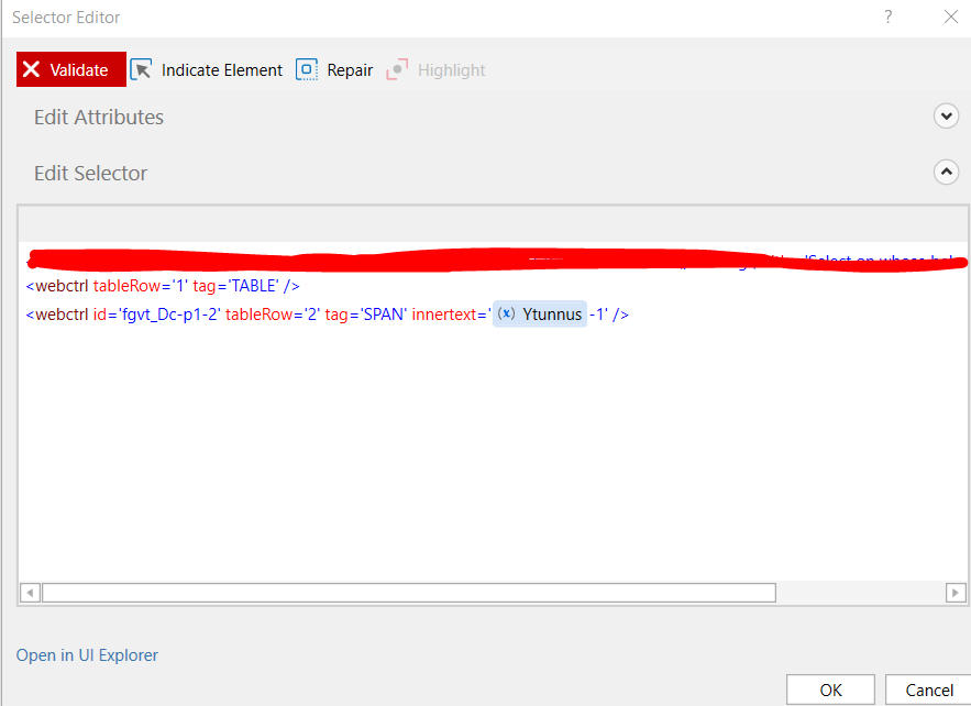

I am trying to add a variable to selector but it doesn’t validating.
SyntaxEditor Code Snippet
Ytunnus is the Variable I am trying to add to the selector.
Hi @subashini,
You need to give your variable a default value.
Your variable doesnt have value right now, so the selector is not validating.
And if you need to make (variable - 1), make this operation in assign and give a new variable to selector.
Regards
Ömer
Hi @subashini
When you set te new variable, please check the override default value option, then it will be able to validate the selector
Regards!
Hi @subashini
  • Go to variables panel
  • search for that variable
  • Provide some default valid value. Check below
  • Now, validate the selector. After your validation completes you can remove the default value for that variable
