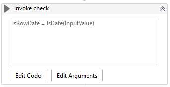

Hi @Mr.H,
you can use invoke code to to run IsDate method on your value.
That will give you a boolean value which you can save into your data table to later filter and/or delete unnecessary rows.
Alternatively you can also try to cast your value into datetime format using
convert.ToDateTime(row(0))
If it’s not a date you’ll get an exception which you can handle and convert to a boolean value and later use to decide what to do with that row.
