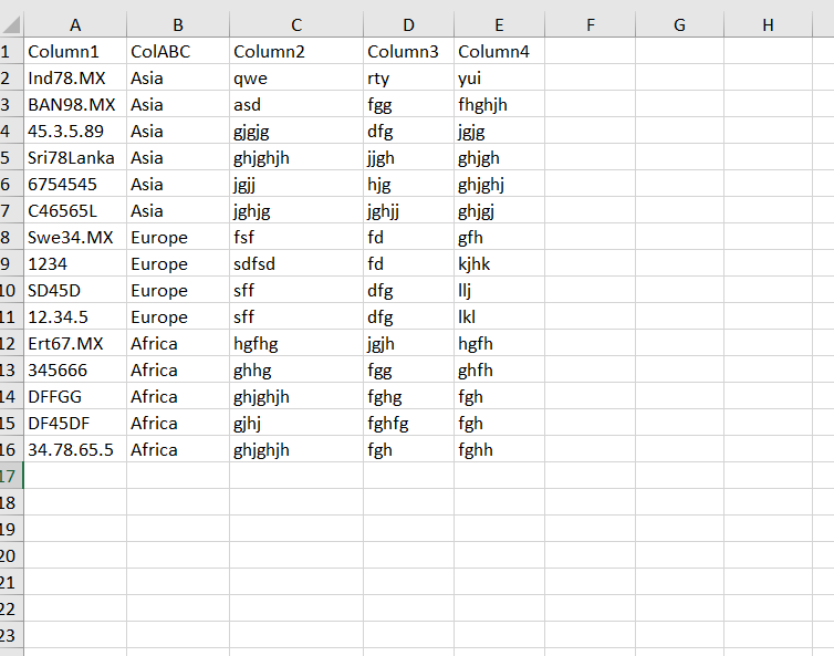

Remove Data Rows from Data Table
i want to delete datatable row below mention example table except header and 1 row.
Thank you.

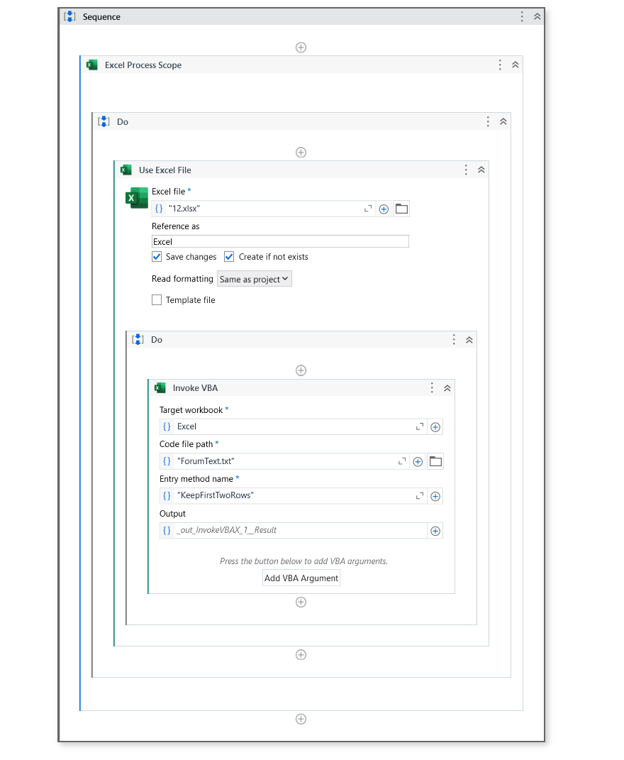

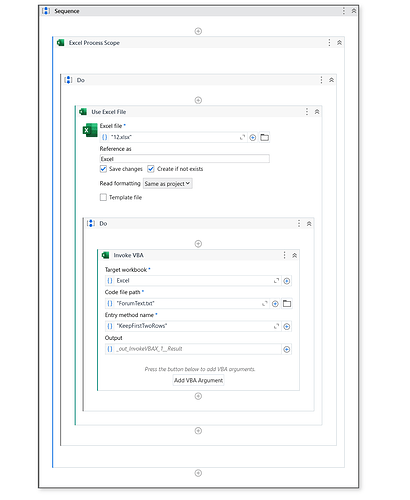

Hi @MD_Farhan1
Please try with the invoke vba. I have updated the code in the below attached xaml please check.
Main.xaml (18.0 KB)
Code Text.
ForumText.txt (721 Bytes)
Regards
Thank You so much bro :+1:
Hi @MD_Farhan1
You’re Welcome bro
