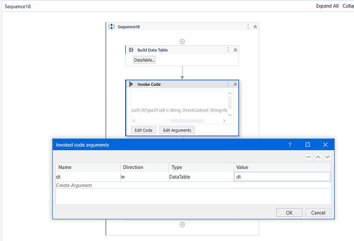

→ Input:
Output->dt
→ Use the below code in Invoke code:
' Assuming dt is your DataTable
dt.AsEnumerable().ToList().ForEach(
Sub(row)
row.ItemArray = row.ItemArray.Select(Function(cell) If(TypeOf cell Is String, DirectCast(cell, String).Replace(",", ""), cell)).ToArray()
End Sub
Invoked Arguments:
Regards
