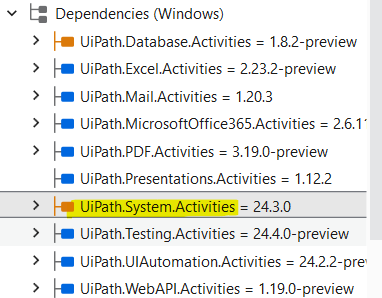

@M_Muzammil,
This is the package I’m talking about
Thanks,
Ashok :slight_smile:

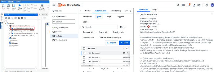

Hi @ashokkarale , I tried with the option of downgrading to 24.3.0 and created a sample script for run in docker robot version 23.10.69.35238-robot23.10.0 23.10.69.35238-robot23.10.0 but I am facing the same issue. Please find the attachment for you reference.
Also I tried with 23.10.x versions But facing same issue.
Kindly provide any other solution.
