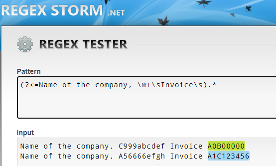

@Angel_Llull - Could you please try this…
Regex Pattern: (?<=Name of the company, \w+\sInvoice\s).*
