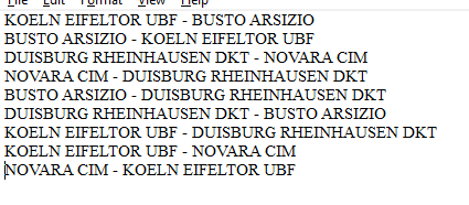

The below are the keywords use to identify the different sections, but if there are going to be other words, then it might be that it is also dynamic ? Or do you have a list of these keywords that we can use ?
