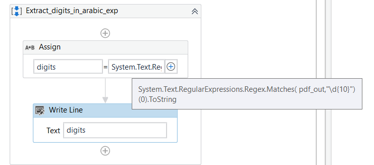

Hi @amit.chaudhary !
Here is a suggestion, you could try this:
Here is the expression used:
System.Text.RegularExpressions.Regex.Matches( pdf_out,"\d{10}")(0).ToString
Does it get you the right number ?
The variable digits here is a string
