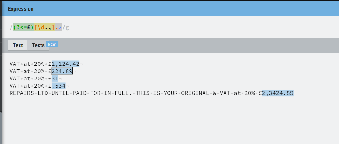

Try this:
Input = "REPAIRS LTD Until PAID For In FULL. THIS Is YOUR ORIGINAL & VAT at 20% £2,3424.89"
Output = System.Text.RegularExpressions.Regex.Match(Input,"(?<=£)[\d.,].*").Value.Trim()
The same expressions will work for all your given inputs @nidhi.kowalli1
Hope it helps!!
