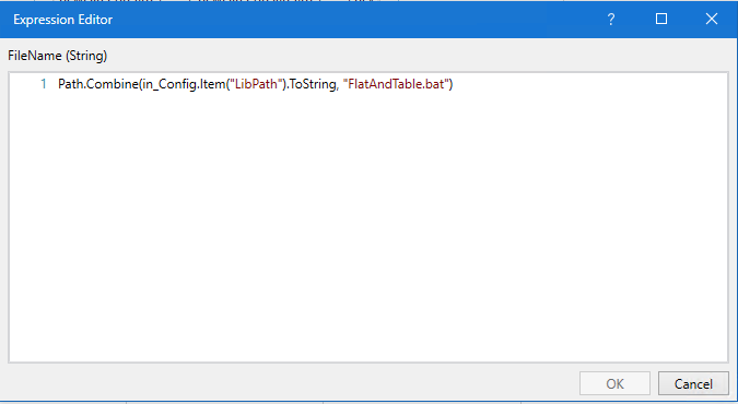

What does “can’t find” mean? Are you getting an error? Which activity? Show the activity and how it’s configured. Are you using…
Config(“somepath”).ToString + “somefilename.jar”
That’s unreliable. You should always use Path.Combine:
Path.Combine(Config(“somepath”).ToString,“somefilename.jar”)
That way it ensures that you end up with a proper path ie…
C:\Somefolder\somefilename.jar
and not
C:\Somefoldersomefilename.jar

You didn’t provide a path there, only the filename. You have to provide the path to FlatAndTable.bat
The first box is the path and filename to the batch file, the second box is arguments to pass to the batch file.

I just attempted to use this as the file path so it ends up being Library\FlatAndTable.bat as the file path but it failed. The error is “The system cannot find the specified file”
