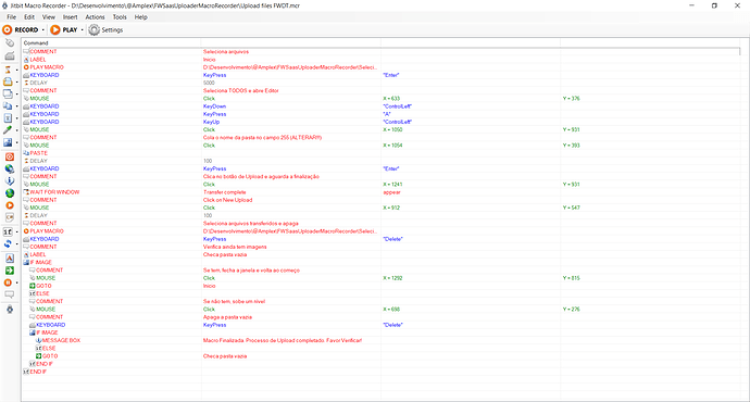

Here is a screen of the feature:
I’ve created two scripts on macrorecorder. One to open and select the first x files in the window (Could not attach files as I’m a new user).
and another one that creates the loops:
In resume:
  1. Open the selection dialog screen;
  2. Change the view to “Details” (in case another view type by icons is selected);
  3. Click on the first file position. Checks if it is a folder (image). if it is loop until it is not a folder;
  4. Copy the folder path to Clipboard;
  5. Select the first X files;
  6. Open the metadata editor and paste the folder path on a field;
  7. Close metadata editor;
  8. Upload files;
  9. Open the selection dialog screen and reselect the same group of files;
  10. Delete them (backup before macro starts, of course);
  11. Checks if folder is empty (blank image);
  12. If not, repeat;
  13. if empty, up one level, delete folder;
  14. Check if final folder (zzz UPLOADER); If not, restart;
