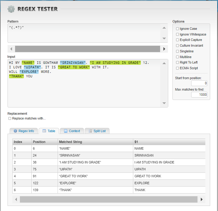

@Gowtham_Srinivasan - Please find the started help here…
Output of Read PDF Text is StrInput
Build Datatable
Regex Matches
Input = StrInput
Pattern = "“(.*?)”"
Assign Activity
Dt = (From m In IEnRegex.Cast(Of Match)
Select Dt.Rows.Add(m.Groups(1).toString)).CopyToDataTable
That’s it, write your results to Excel.
Output
Hope this helps…
